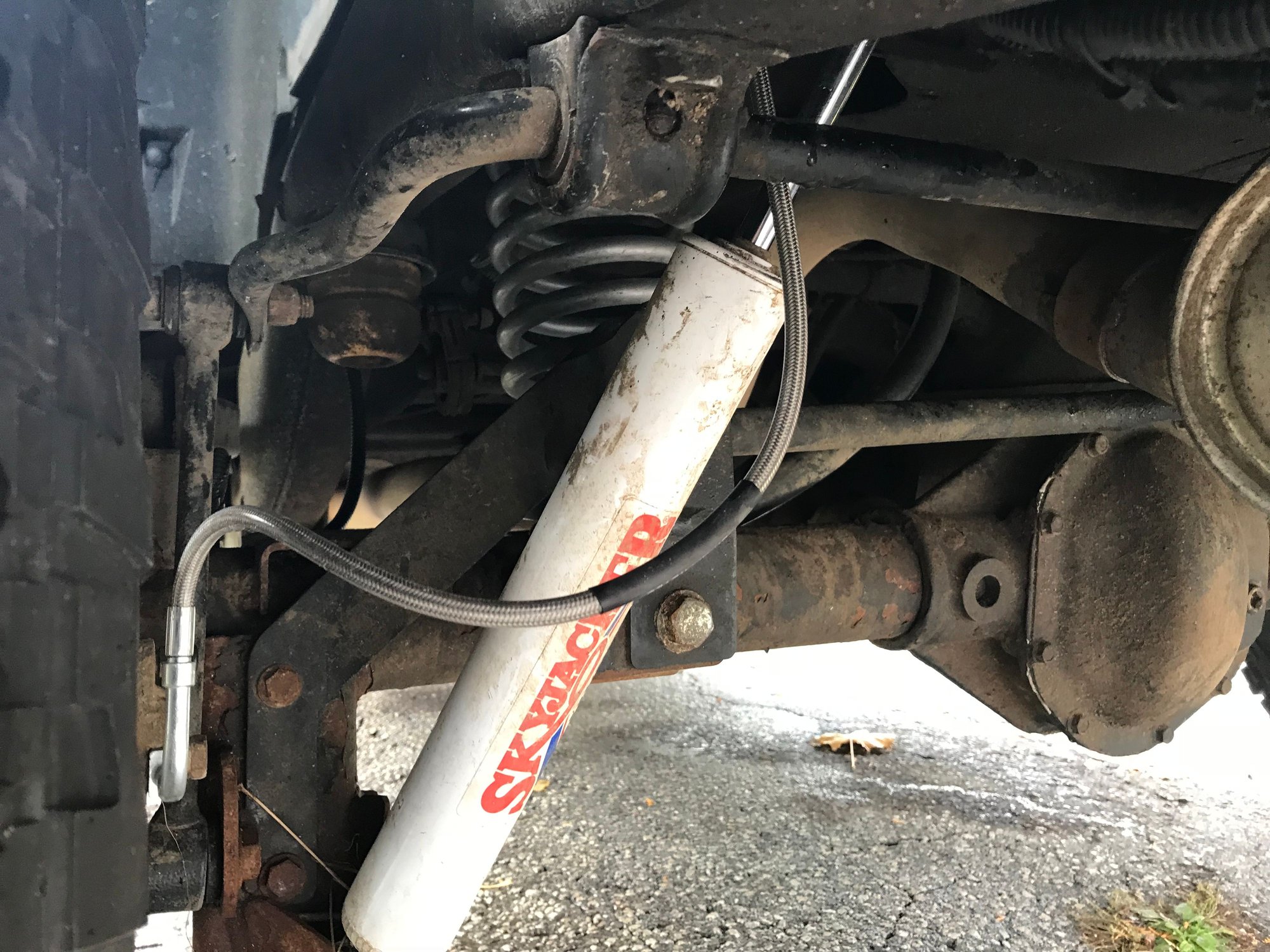

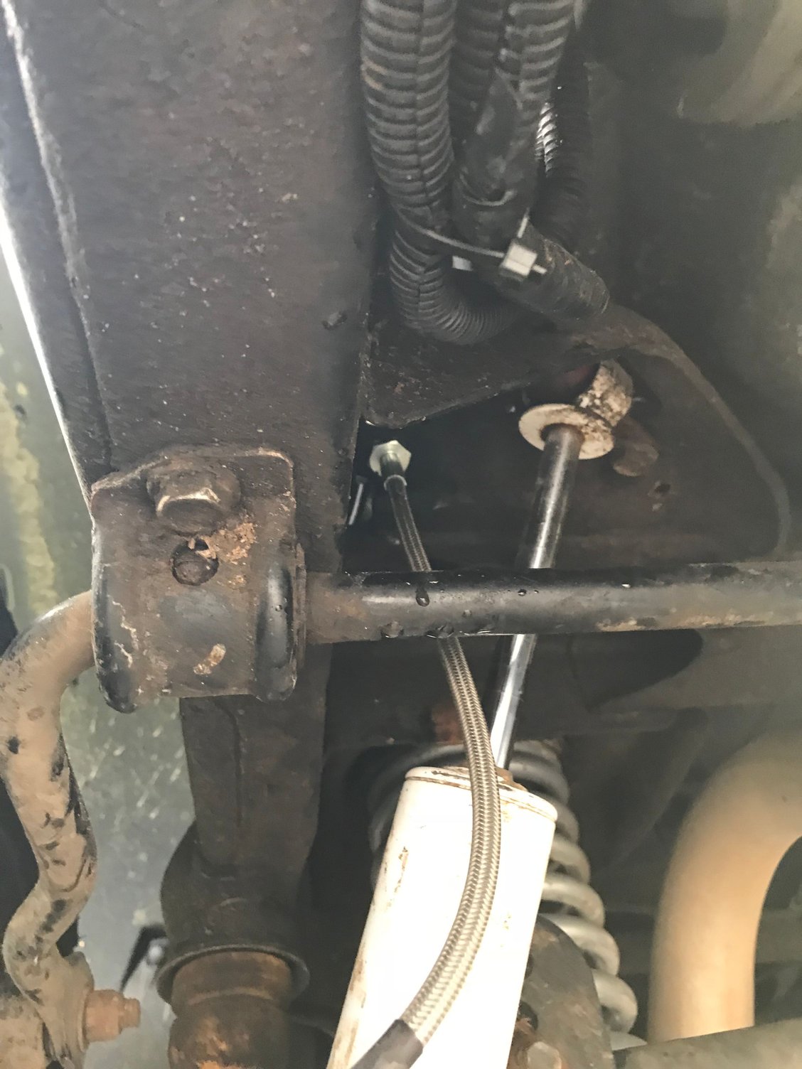

After two mishaps and getting tired of carrying extra brake line and a flaring tool I decided to reroute the brake line through the rear shock mount like Currie recommends with their anti rock sway at kit.
Just used a cheap set of rough country braided lines. Worked great.
They do not touch the shock or sway bar but put some rubber fuel line overtop anyplace they could rub and secured with some hose clamps.
