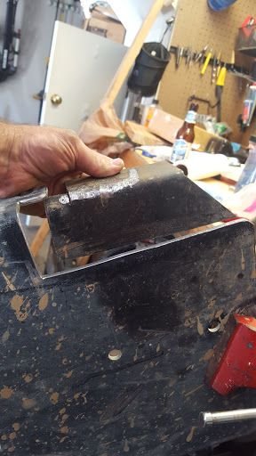

This is the current state of my gas tank "skid":
At this point the tank is sandwiched between the "skid" and body, and the tank itself is crunched a bit. Going to have a fun weekend dropping the tank and beating the skid flat with a sledge hammer .

Totally agree on the skid. 3/16" is 3/16" there....it's all the same....and it will all dent to some extent. I’ve also no clue how some can get way charging so much. I will say, I also just had to cut big corner off my RH skid….back on the rear on the inside. 1350 DS had huge clearance issue. That RH skid comes down and is bent at a 90* angle. It’s amazing how much clearance you lose with that over how the factory bends, or where the RC and RE skids stop. It’s not like it really adds additional protection. The cheaper skids still bolt up to the same notch back there.
(cardboard is just blocking the sun for the photo)
