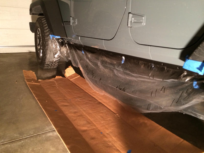

Plasti-Dipping the Pinch Seam
The pictures don't really do it justice but the plasti-dipping came out really well. It's a very forgiving material to work with. I had some streaks after the first coat but that evened out after the second coat. As it dries, it looks better.
I pulled the tape off after the second heavy coat to make sure I got a nice edge. I opted to run the tape along the bottom edge of the angle above the pinch seam. That way the black edge is hidden from view.
Again, sorry for the lack of light. It's 22 degrees out today.

Back at It This Morning
The temp is actually higher but it feels colder because the wind has picked up outside and there's no sun. I can see my breath.
Here's a pic of the plasti dip outcome again.
