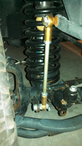

Old Jun 14, 2013 | 04:56 PM
BeachJK's Avatar
Posts: 439
From: Altamonte Springs, FL
Originally Posted by backwoods-jeep
hey guys got a set of quick discos for my rig finally off another forum member but they have no install instructions and im kinda lost because i have a 2.5 in lift and thats what these are for but there longer then my stock sway bar connects and theres some plate with them i tried using rock krawlers instructions on there sight but it wont open for me maybe this is a dumb question but i could really use the help
Does this help?
Old Jun 14, 2013 | 06:02 PM
mcmahonbj's Avatar
Posts: 387
From: Quad Cities, IA
Originally Posted by BeachJK
Does this help?
Attachment 467993
At least I am not the only one that has that piece rusted, they need to change their material.
