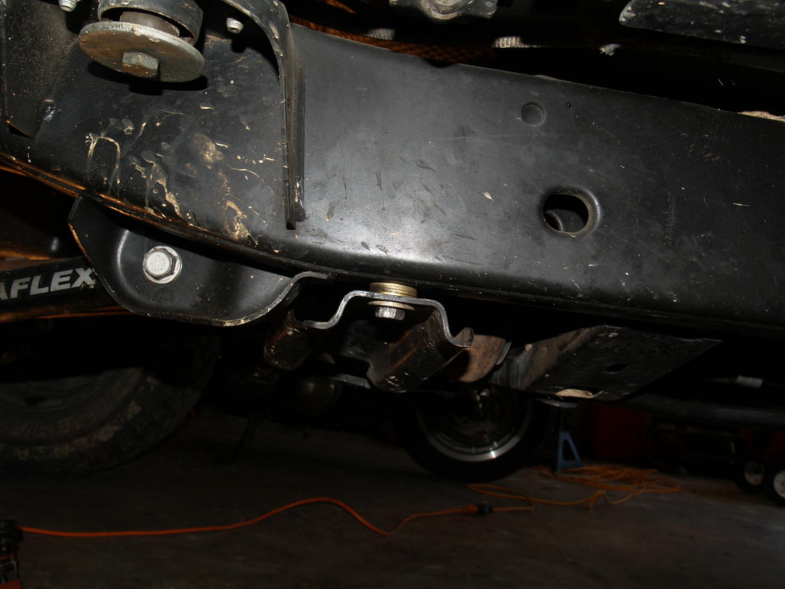

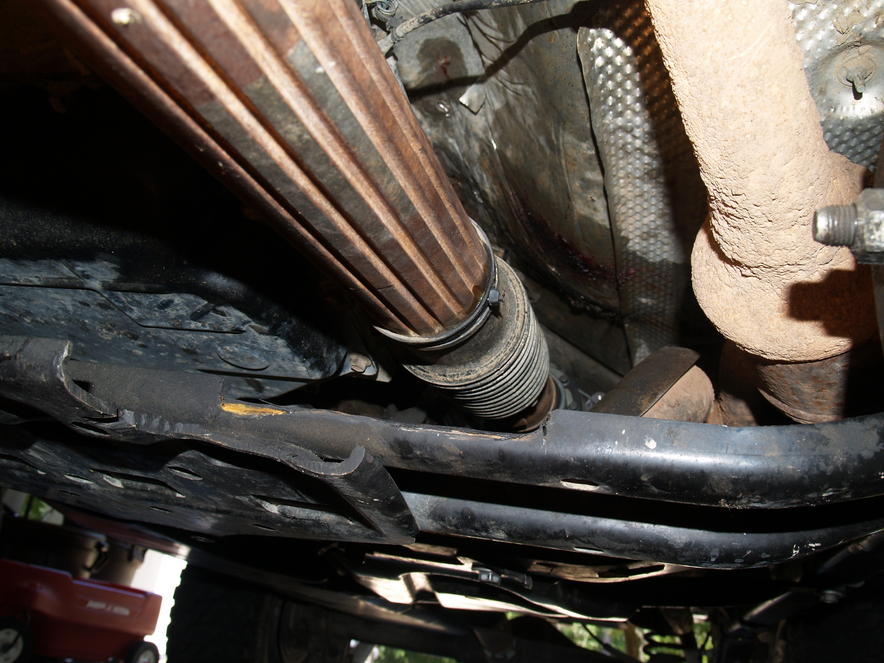

Old Jul 25, 2010 | 05:37 PM
mkjeep's Avatar
Posts: 15,665
From: Hammond Louisiana
Old Jul 25, 2010 | 05:50 PM
superbee's Avatar
Joined: Nov 2007
Posts: 87
From: Strasburg, CO
glad to hear it! i just wanted to make sure that i wasn't going to be running around with a naked tranny. Cutting that out doesn't look too bad, what did you use to cut it? I have a decent selection of tools, but not sure that I have anything that would make it through something like that.
