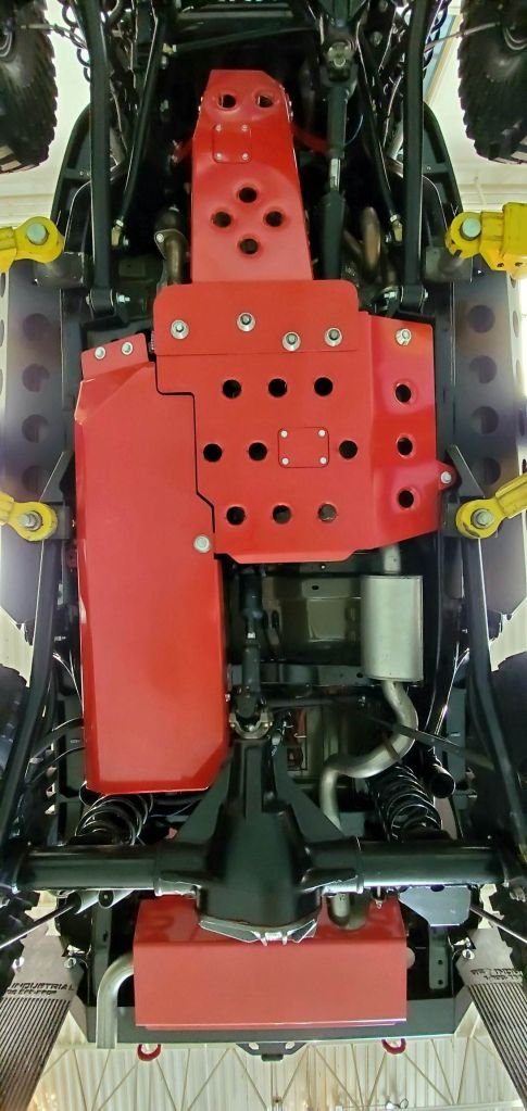

Hah, hah - maybe I just like fabricating stuff - but ....
I’m in Sv_dude’s camp - I’ll use the protection now, so things are still rosey the next morning.
TheDirtman, MrClortho, and resharp001 are wayyyyy more knowledgeable about this stuff than me - but I gotta admit that skid plates were one of my first considerations !
To the Op - likely the Oil Pan & Transfer Case are the first pieces you’re gonna get - but you can add to your protection as you go along.
Here is a shot of the plates I fabbed up just back from Powder Coating
And here they are installed - ohhhhhh now THATS pretty sexy !
Of course, they don’t look quite that good anymore - but they keep me in one piece !
Hah, hah - ok guys, demolish me !

Neville, those look great....as does the entire undercarriage.
I guess I just stress for each to be honest with themselves about use, terrain, and what they really need for protection. So many people feel they need skids, but really aren't wheeling like you guys are. I'm not opposed to full skid systems, but in reality they are just extra weight for what many are doing. There was a time I was also in the camp of "meh, it's just a few more pounds and I'd rather have <fill in the blank>". It sure does add up over time though. Sounded like OP is on a budget and will need to piece things together over time. Start with a cross member, protect the oil pan in some form or fashion and go from there. If wheelin continues down an aggressive path, by all means protect things.
