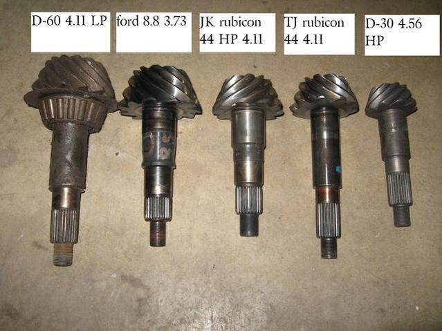

One of these things is not like the other.....
