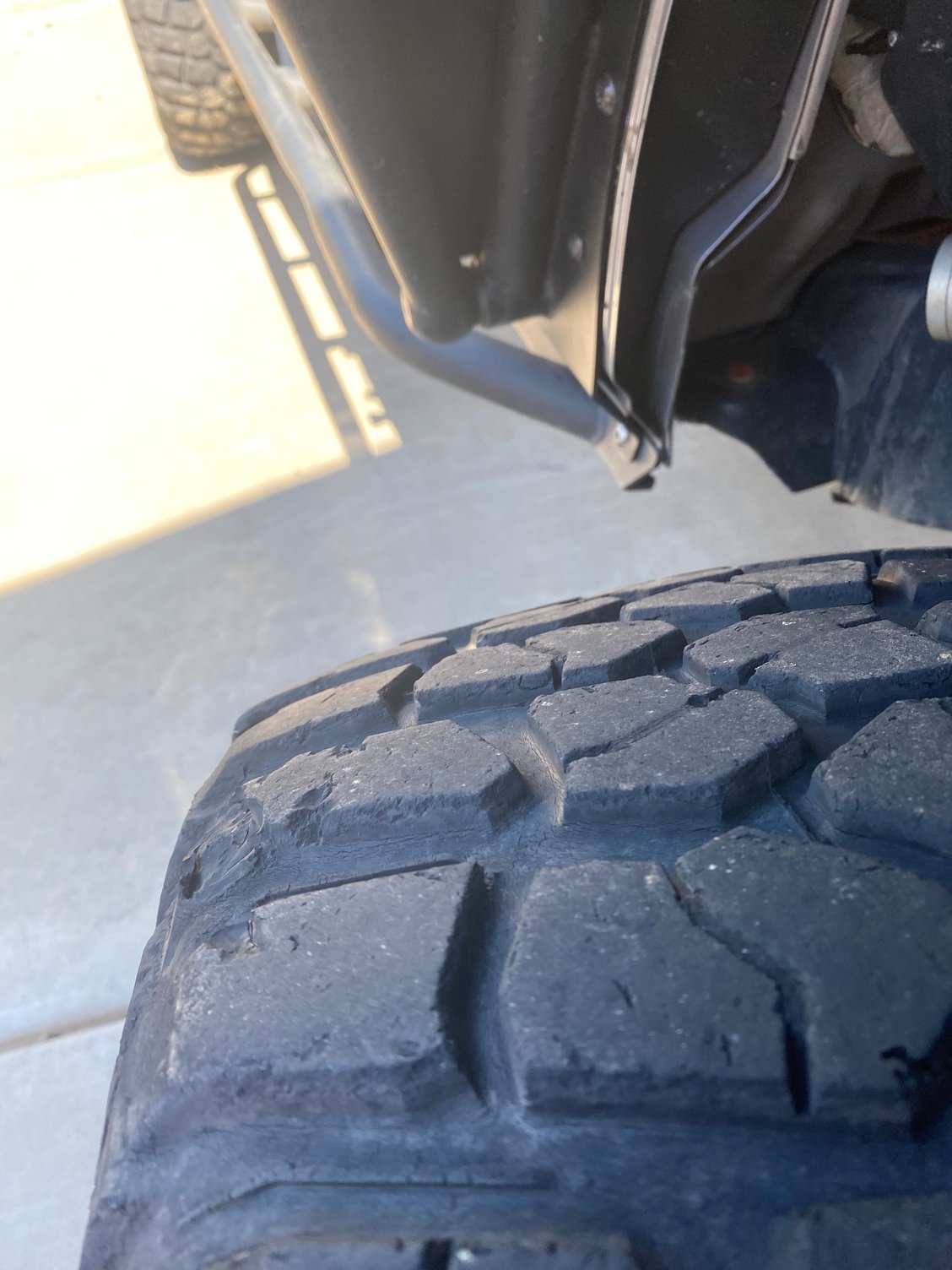

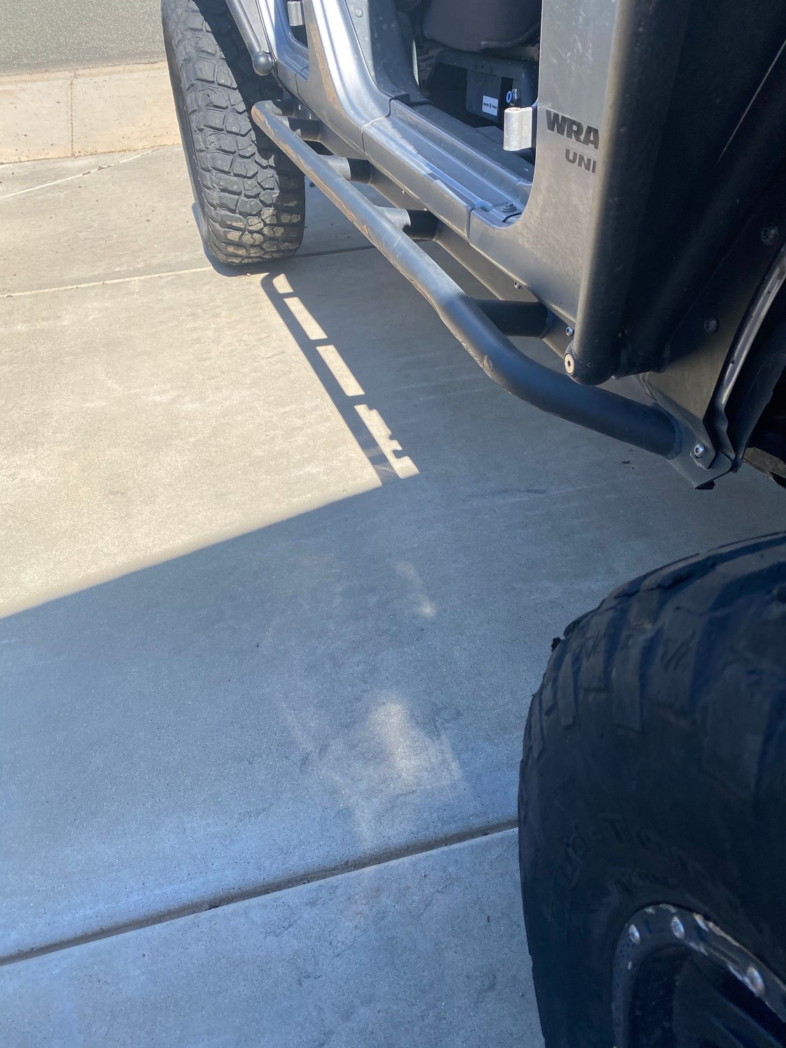

So, I’ve researched a bit and some people swear by the body mounted sliders and others lean towards frame mounted sliders. Ive always had Toyota’s in the past and frame mounted sliders were the way since there wasn’t really a good option for a body mounted slider.
It appears that my sliders are bending the sheet metal on my body. I’ve taken some good hits to the sliders but nothing I would typically be overly concerned about. But after looking, I do believe my sliders are bending the bottom of the body. Anyone else have this issue?
I’ll likely make new sliders in the future and weld to the frame to take the stress off of the body.
Here’s what my sliders and body look like:

I can see that happening. I had welded tube to my old rubi rails and they flexed similarly. Do you have those bolted to your body mounts on the underside as well? IMO, it's not totally fair to lump all "body mounted rails" in one barrel. For example, a lot of the boat-side sliders are body mount, but attached to the body bolts and then to rocker armor (bypassing the pinch seam and lower rocker). If not going with a version that mounts similarly, it does seem frame mount is a better idea, but seems you often lose a little clearance that route too.
On my old sliders, the tube was welded similar to what you have in that it stuck straight out. One thing about running them that way is when you're leaning on the slider, it's sure a lot of leverage being applied as opposed to if you had welded it up at an angle from the pinch seam (think along lines of PSC Rocker Knockers) which would have given you a little more clearance, and when you were on them probably would be a little less pressure applied to the mount.
