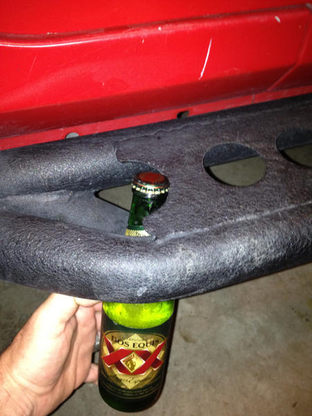

Just a side note as an added bonus...these also have a built in bottle opener...
