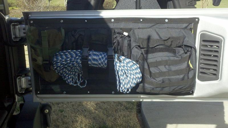

Originally Posted by augichef
I screwed the top left corner then pulled it tight and then drilled the next screw in. I also stuck 3m heavy duty Velcro strips around the edges between each self tapping screws. I got a lot of weight on mine and I haven't had any issues with sagging. I also add a long strip of Velcro across the top so I can drape a black cloth over my gear to somewhat hide it when the top is off.
<img src="https://www.jk-forum.com/forums/attachment.php?attachmentid=244260"/>
Same here (- Velcro).. Just crew in corner and work your way across while pulling it tight... I've added a flashlight and long flathead screwdriver since this pic... All my winch gear is inside the bags...

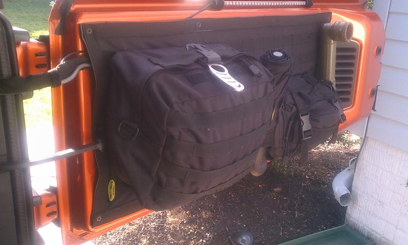

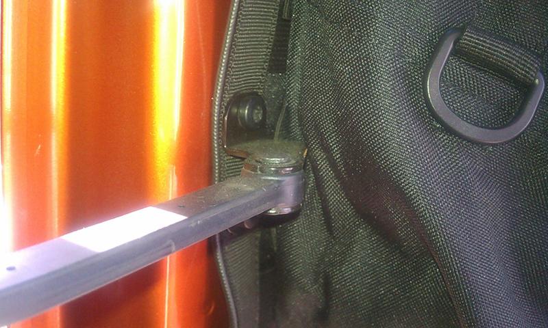

Evo35's Avatar
Posts: 508
From: Northern, Virginia
For those with the arm that comes out with the door. I attached over the product. As you can see, I had an issue with some gap. Its the only place I have that problem.
<img src="https://www.jk-forum.com/forums/attachment.php?attachmentid=244864"/>
<img src="https://www.jk-forum.com/forums/attachment.php?attachmentid=244865"/>
I have a bit of a gap in lower left as well.. I thinks it's mostly they way the tailgate is constructed...
