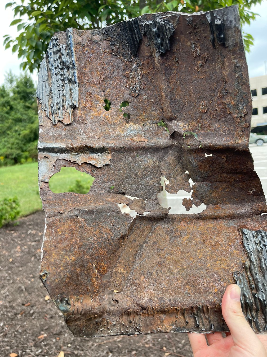

Water gets soaked into this stuff and gets trapped underneath and speeds up rusting, a common rust area on these tubs you will have to watch out for is the driver floor pan. It gets exposed to the most water and when the carpets get wet and it soaks down to the goop, its impossible to get it out. Here’s what my driver pan looked like after years of getting caught in the rain with no top…. never again.

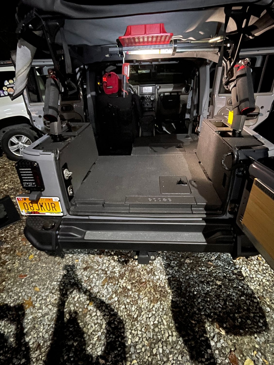

Yes, I have. Sorry, haven't gotten around to posting about that yet. Here are some pics of it all together
I got my hands on a used set of 2011+ rear carpets , the earlier models aren't compatible with the plates
Here you can see on the passenger side I added a Blue Sea 12V & USB outlet with a voltmeter on it, as well as a 2 way rocker switch for the auxiliary interior lights
Here's with the Kitchen opened up, it makes for just enough standing room between the stove and tailgate table to conveniently have your prep surface right there, then just a quick turn around and you are at your cooking surface
Here's some of the other custom touches I did to the plates, Blue Sea 12V and USB outlet (minus voltmeter) and 3 way switch for my rear glass lights on the back part of the passenger side. I haven't cleaned up the wiring and put it in a loom and secured it to the side of the top yet, but that will be done soon. I just finally installed the lights last night
Outlet for the Fridge on the driver side, I need to put the cable in a track so that it can more easily run along the slide without worrying about catching on anything and causing damage
And finally, the Blue Sea fuse block under the 60% delete, this delivers power to all of my auxiliary interior accessories, all of my exterior stuff is controlled with a Switch-Pros SP8100. It all came out pretty good and I'm happy with the results. By no means am I a professional at any of this stuff but I just take my time and do it right, I wanted troubleshooting or adding circuits to be easy, and everything very simplistic and safe
