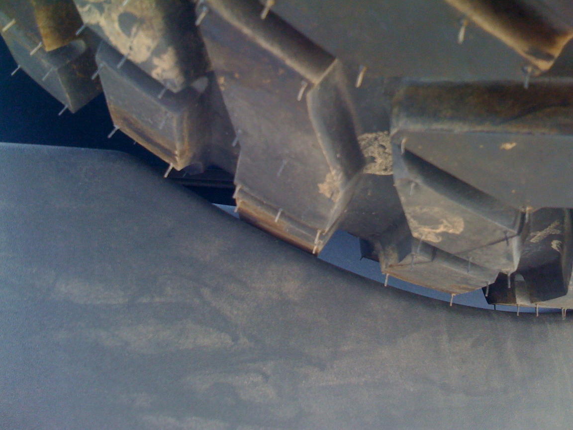

I have 35x12.50 baja claws here is a pic of the fit. Close to the bumper.
No problems in 1500 miles. Mixed on and off road.
