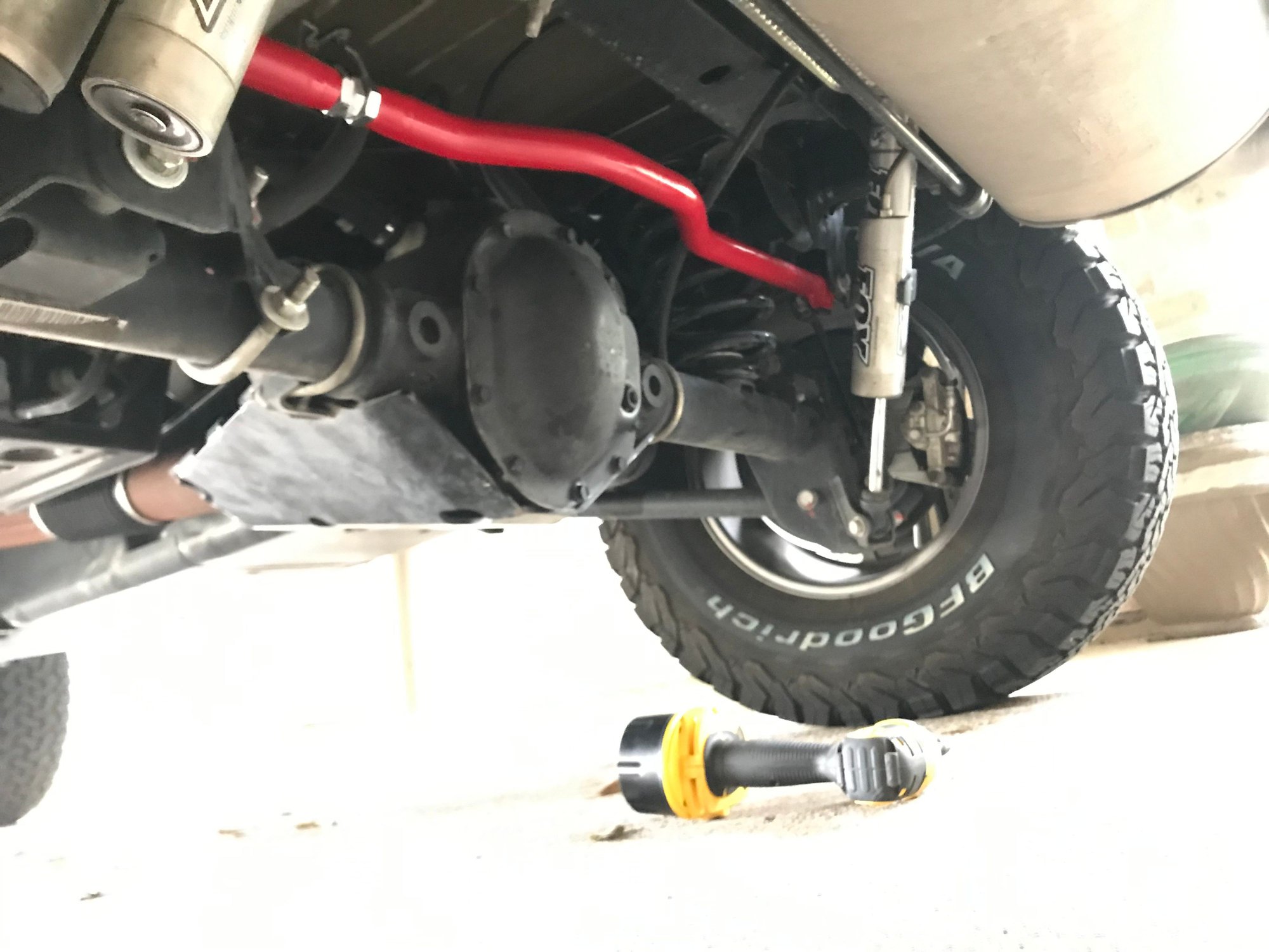

quick Saturday install. I wanted an adjustable rear track bar, even with my relocation bracket my rear axel was off over an inch. I went with the Spohn rear adjustable bar. I had their tie rod on my 09, I was impressed with it overall. The spohn track bar was under $200, less than most others out there, plus rebuildable bushings with grease fittings. It feels a bit lighter than the stock bar but should be stronger. The install was ok, however, one shock reservoir had to be unmounted to get the bolt out on the driver’s side and that bushing was also a tight fit in the bracket and difficult to align.
