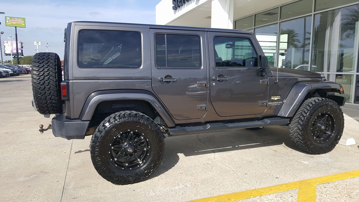

New to the Jeep world, but have some steering/tire shaking and lane shifting on the wonderful roads that we have in Louisiana (It drives great on the interstate and better state highways). I have owned several lifted 3/4 ton trucks and installed steering stabilizers at the time of the lifts with 37" or bigger tires. Would a good single or double steering stabilizer set up work best?
I am looking at this kit: https://www.fortec4x4.com/FORTEC-983...angler-JK.html
Details on Jeep:
- 2014 Sahara Unlimited
- Teraflex 1853100 Springs
- Bilstein Shocks
- 18" Fuels
- 35 x 12.50 Nitto's

3" coils? How much lift height did you actually get? What is the caster set at? Have the tires been re-balanced? What psi are you running? Is there bumpsteer?
Most here will tell you that the stock stabilizer is fine, assuming your steering is set up correctly. (some don't even run a stabilizer.) So look elsewhere before dropping money on this...

I would suggest addressing the underlying issue causing such shaking rather than covering it up. You're jeep should drive solid without a SS if everything is in good working order, caster is correct, joints are good, and bolts are torqued to spec.....regardless of tire size. You should be able to drive without a steering stabilizer at all. The fact that you have some shaking/lane shifting speaks to having underlying issues. I'm not saying you should run without a SS, many do.....but my point is you have a problem, and SS isn't going to be the answer.
