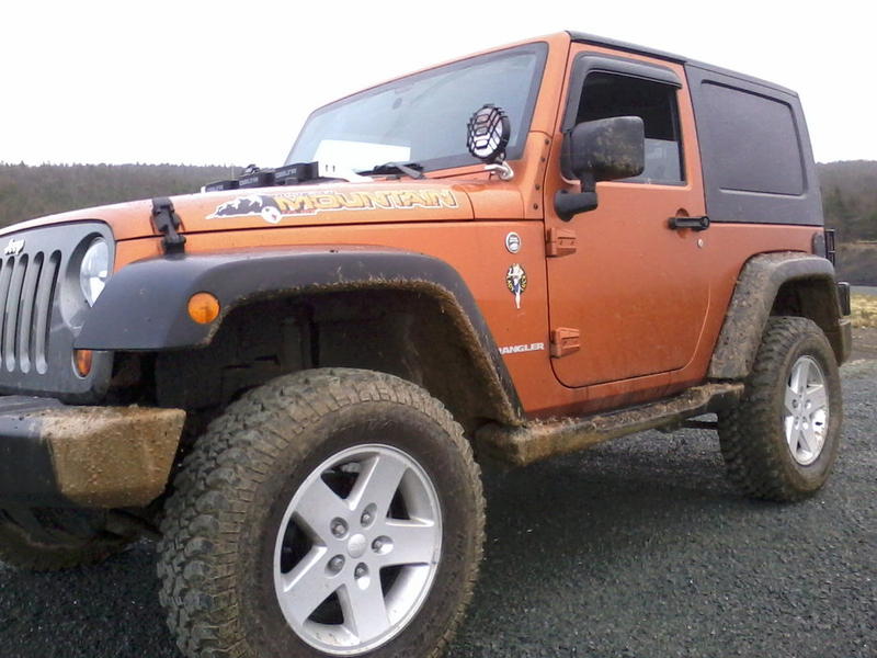

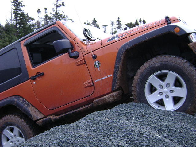

Default here she is!
ID:	426644Click image for larger version
ID:	426645Click image for larger version
