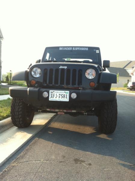

What cheap alternatives are there for disconnects? I tried using cotter pins from tractor supply but they pop off when I corner on the street.

Ripped off my rigged up disconnects this weekend. Finally installed a set of trailmaster JKD disconnect for $60. They look great and are sturdy and functional. Ride is sturdy again!
