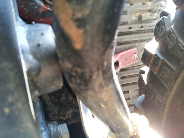

Swaybar issue..
Old Jul 16, 2012 | 06:16 PM
superjk10's Avatar
Posts: 330
From: grande prairie
They are straight at 90*
Old Jul 16, 2012 | 06:28 PM
kaptkrappy's Avatar
Posts: 1,220
From: Punta Gorda, FL.

Yours looks like it has to be pointing up like the links are way too long.
Old Jul 16, 2012 | 06:33 PM
superjk10's Avatar
Posts: 330
I was flexed up in the picture i took...
Old Jul 16, 2012 | 06:36 PM
nvertflyer's Avatar
Posts: 357
From: torrance ca
your sway bar should be be within plus or minus 5 degrees parr to a flat surface..you can use a angle finder and adjust your links as needed but your problem most likely is your axle has shifted due to the lift..measure the difference from your frame to a consistent part of your tires,note the difference and adjust your track bar as needed..these two things should fix your problem...
That makes sense then....yeah either disconnect or take a grinder to it.
Old Jul 17, 2012 | 03:16 AM
kaptkrappy's Avatar
Posts: 1,220
I would say that you were using the E-Disco (disconnected) while flexing and taking this picture.
With 37's and a 3.5 inch Max Travel lift (installed and adjusted correctly) the sway bar (even disconnected) should not hit that high on the frame.
You have adjustable links with the Max Travel, just shorten them up and see if you can adjust the rubbing/contact out of it.
Disclaimer; I am just guessing without actually seeing it.
Old Jul 17, 2012 | 05:27 PM
superjk10's Avatar
Posts: 330
I Will adjust my links shorter tomorow.. I only have 1/4" to play with.. I dont know if it Will change anything since its just 1/4"..
The jeep is aligned perfecly..
I Will keep you posted.. Thanks for thé input guys

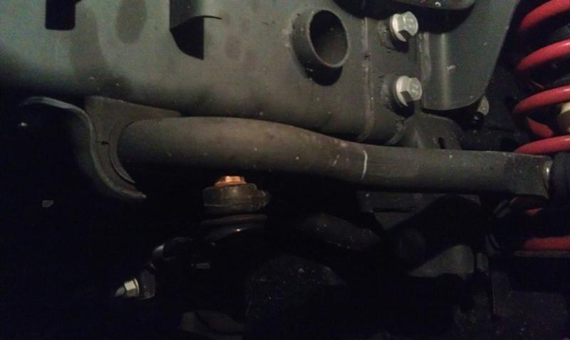

Old Jul 18, 2012 | 01:29 AM
EzK's Avatar
EzK
Posts: 1,350
From: MD
If you have a Rubicon and your links are too short for your shocks this WILL happen. So, leave them as long as necessary and don't worry about the angle.
