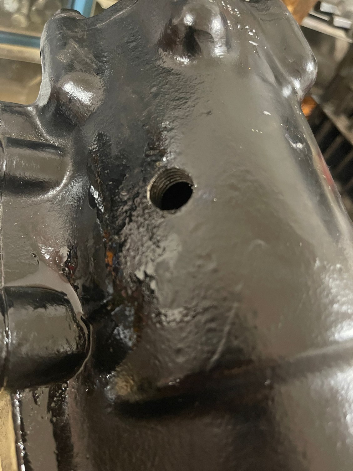

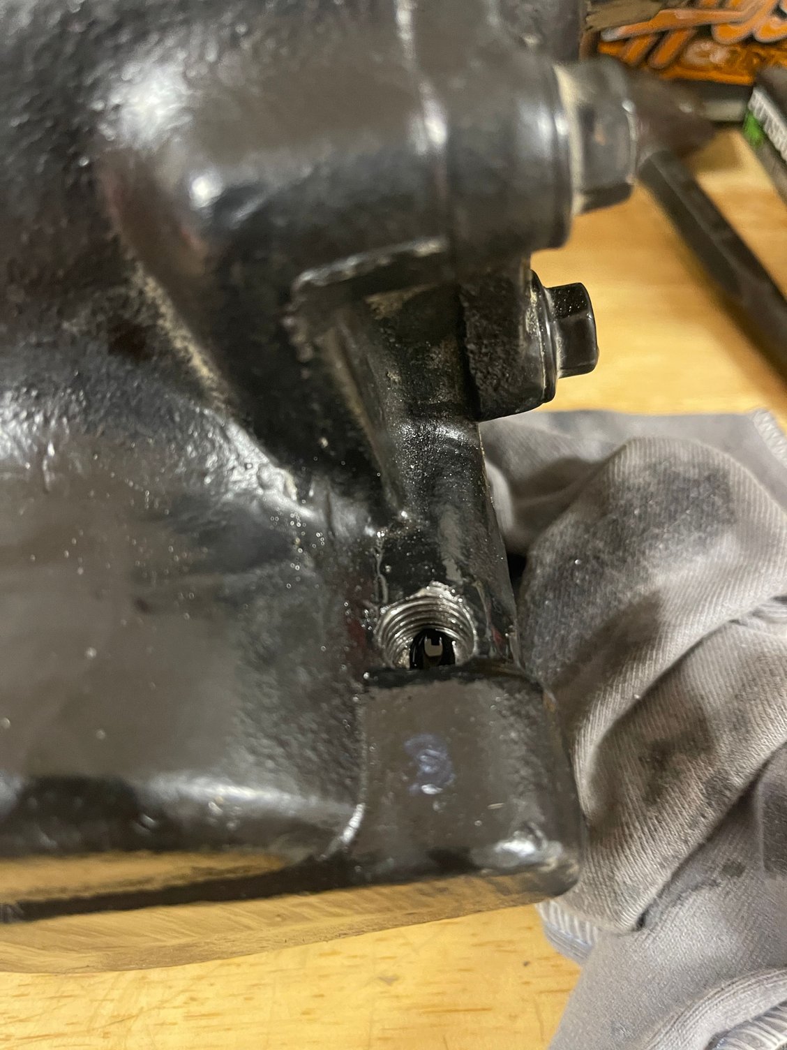

@XJRefugee thanks for jumping in on this for me. I did a lot of searching and PSC actually uses a completely different cap on the unit where it goes out to the intermediate shaft and it’s beefed up to accommodate the fittings. I do mostly rock crawling and my end goal is to add the ram I already have to the set up as I creep towards 40s. After a lot of digging it would seem the box is exactly the same as a stock box except much more heavy duty minus the special section psc adds. So I went ahead and drilled the box as if it were a stock unit. I’ll be installing it today so we will see if I just wasted $500.
The rear fitting isn’t dead straight but it has plenty of engagement and the hoses clear so I’m not to concerned. I’ll be back on here later to either celebrate or to post pics of a tapped stock box. 😅

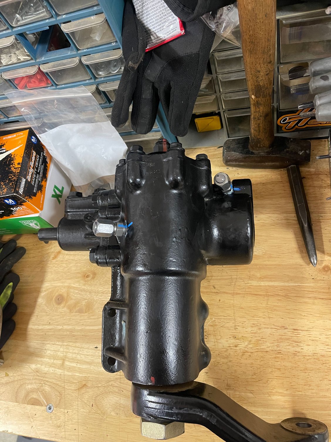

As for the drilling the box is pretty thick so I’m happy about how deep I could cut threads in the unit. Talk about stress though.
you can see the case is beefy in the pics. I know it’s overkill but this is the third box for me and I don’t want to pull it to drill it later. I used a magnet and grease to trap the shavings and cleaned out the holes repeatedly after tapping. Since the unit was used it was full of fluid and I got lucky that it pushed out of the housing as I was working. I shot several videos of the process and if it works out in the end I will share them. My current box is under warranty so I’m going to exchange it and drill and tap it as well, I’ll keep it for a backup or sell it to someone in my group of wheelers.

I appreciate all the feedback, the box works amazingly well on its own I got it installed this morning. I have the cooler in my parts pile, I ordered it at the same time as the ram so i will definitely be putting it in. I’m going to check on those washers as well. I think the larger res is definitely in order as well and I’ll grab one for when I install the ram. Only issue I had with the install is that I seem to have busted my clock spring so that’s going to have to get taken care of now as well.
