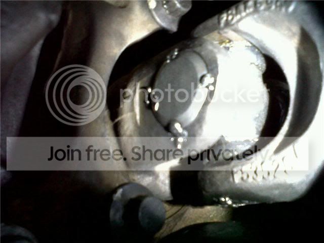

Here is a cell phone pic of the tack welds on one cap. It is not pretty and doesn't look like much, but so far it is working good.
If you already have a welder this cost next to nothing to do, and only takes 10 minutes.
