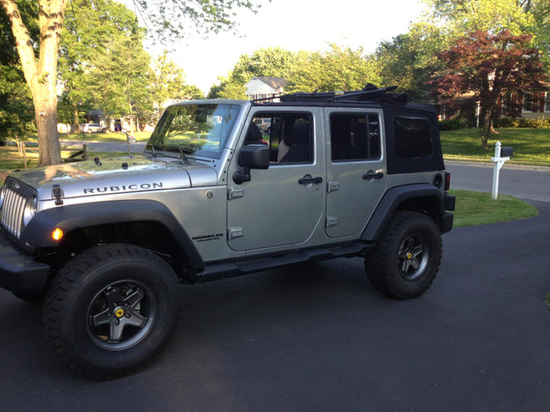

chad s Sep 11, 2013 04:57 PM
1 Attachment(s)
Here's what your jeep will look like with lteraflex lift
Attachment 496746
jeep_pride Sep 11, 2013 05:05 PM
<img src="https://www.jk-forum.com/forums/attachment.php?attachmentid=496746"/>
Awesome stance! Looks great!
