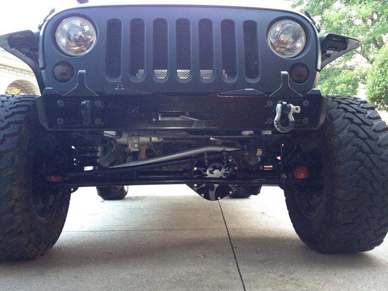

I have the TF 2.5" BB and have been running it for about a year and a half....you will have no issues out of the box. I upgraded to the RK Bombproof Track Bar mainly for strength reasons. My axle was off only slightly but it is dialed in perfect now. One of the best things I added was the AEV correction brackets to put the caster back to factory specs. The drop brackets really took care of the flighty feeling. Next upgrade is the tie rod to a Poly cause my stocker looks like a pretzel.....lol

<img src="https://www.jk-forum.com/forums/attachment.php?attachmentid=496747"/>
Has the RK Bombproof track bar given you any problems? That's the one I've been looking at to purchase for my jk

no issues...lots of adjustability...with a 2.5" lift I only need to make it approx. 1/2" longer than stock to get things centered....like I said the main reason for that upgrade is the fact that it does not flex or bend like the stock when under load.
Alright thanks for your input. It seem to be a good trackbar upgrade for the price. I'm mainly just trying to center it and reliability.
