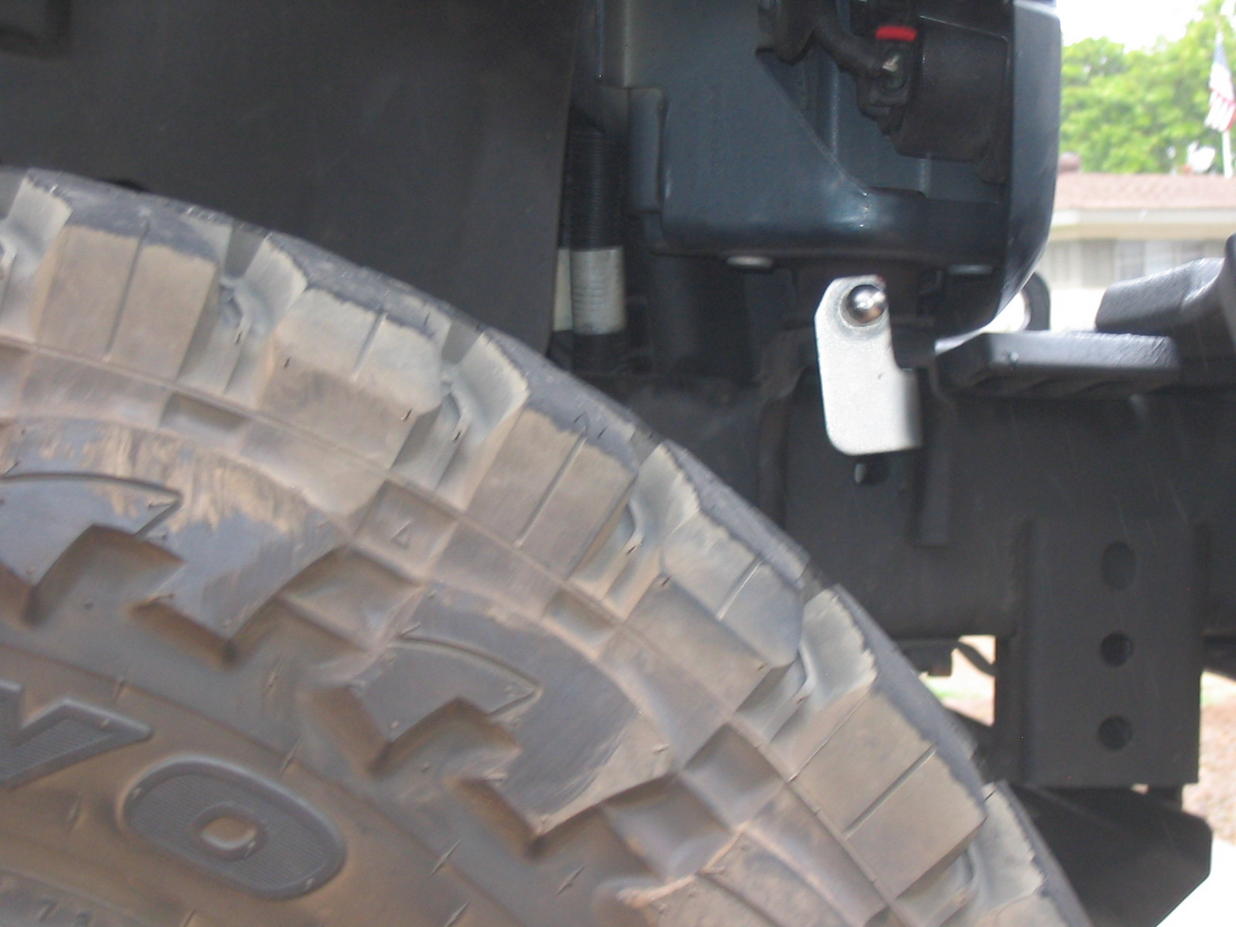

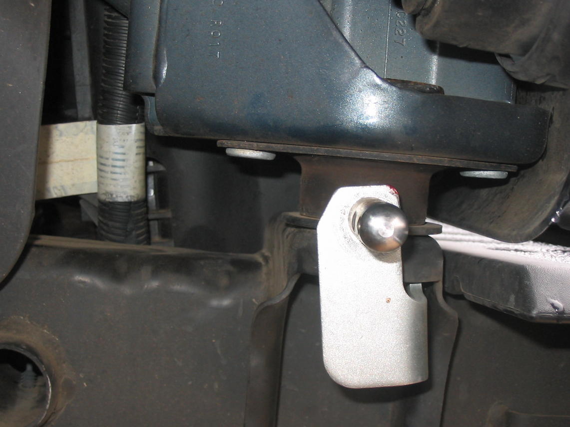

Default Here are some pictures
Here are some pictures of where I was talking about. I also took a picture of the new linchpins I am going to try, I don't think the tire can take these out or grab them.

Sadly to say I tried the new linchpins today and unlike I thought , the tire still ate one. I did have a spare clip which did work the rest of the trail rid. The pain is I have to go out and get another washer and linchpins (just in case).

Can you post a pic of the bracket that you have?
