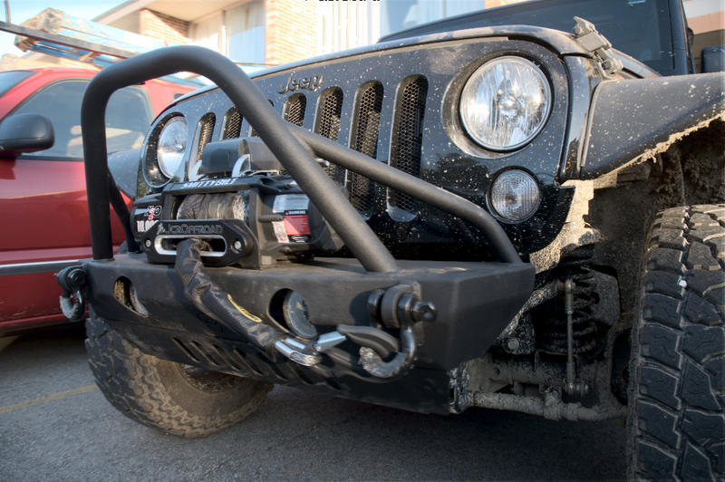

I installed the JCR stubby with recessed winch. Cut the vac bracket, used the new bracket, no issues. For the front plate, I drilled and tapped the bumper and bolted the plate on.

I have the JCR Stubby with factory fogs. No modifications to the JK at all. I believe that any bumper with a recessed winch (mine is not) requires moving the vacuum pump.
However, JCR provides the bracket and instructions to move it properly.

Any bumper with a sunk down winch will require relocating the vacuum pump on 2012-2014 JK's. It's one of the trade offs for the design.
It's not a big deal and easy to do. We've even had customers that have told us that they only had to cut the threaded stud off the top of the factory bracket for the bumper to clear.

I think you'll find it very hard to find a recessed winch, stubby bumper, with factory fogs. There just isn't that much room in there for all of that and make the bumper string enough to handle a winch pull.
The JCR line up has always been a favorite of mine. I have the Dagger, which has factory fogs, but not a recessed winch. I believe the have another that has the recessed winch, but not the factory fogs.
If you found one that had both options, I would look closely at it to see just how strong of a bumper it is. You might lose something that you CAN'T see and it might to be what you want.

personally i think im gonna get a dagger front bumper this fall, the winch isnt recessed so no vacuum pump clearance issues, and the dagger is smexy.
