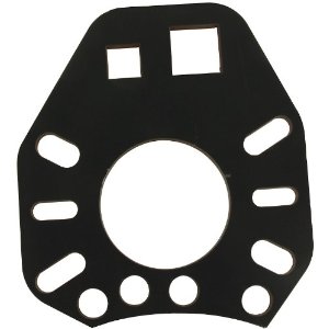

Or if the diff is not removed from the Jeep; I use one of these with a breaker bar against the floor or frame and you're free to torque with both hands on torque wrench.
Attachment 468245
However, the easiest (and best) way is to carefully use an impact as necessary to acheive the proper preload in in-lbs of torque. 10-20in lbs for same bearings, 20-40in lbs for new.
The flange bolts aren't strong enough for one of these when crushing the crush sleeve. I bent two plates and idk how many bolts.... But for what the OP is trying to do this will work.
Never had an issue yet w new crush sleeves myself.

Originally Posted by GunDude
What is it called and where do you get it?
I have this Ratech one Pinion Yoke Holder Tool Ratech 18001 : Amazon.com : Automotive
and I've not had any bending issues. I could see that happening if the tool is not tightly bolted to the flange I suppose but I've always made sure it was. YMMV
