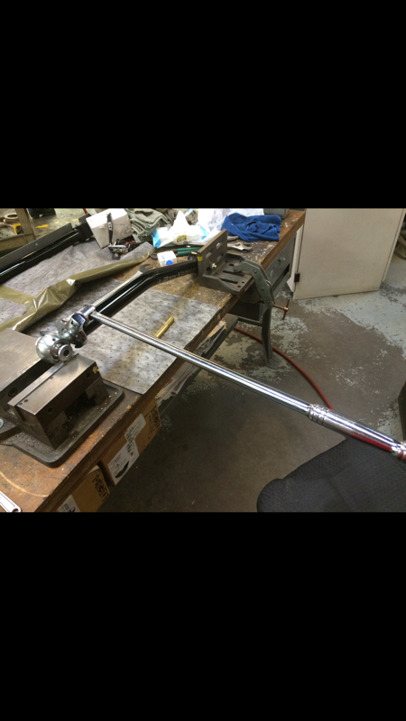

How i held mine

Same way that kjeeper10 did his, or you can use 1 vise and a long screw driver in the opposite end have have someone hold it straight, then rotate it and do the same if it is a krawler joint to krawler joint!
