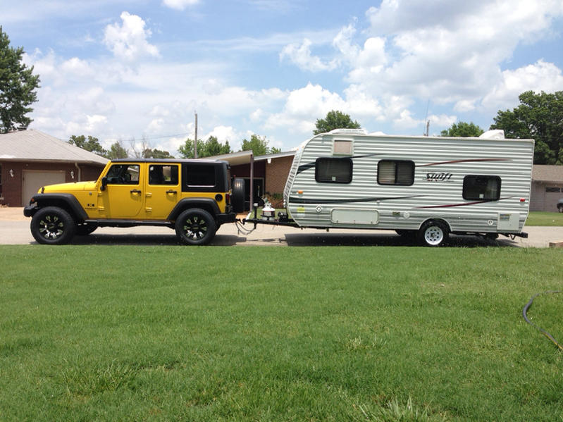

I have a '08 with 3.73 tires are 34x11.5-18 i put electric brakes on mine but i pull a 20' camper right 3400 lbs it pulls it the hill are tougher. I will be putting in 4.56 when I can . I'm going with 4.56 because the piñon gear is thicker on the shaft. I have more prob with the tranny wanting to heat up climbing than i do pulling. I have never had it overheat pulling my camper
