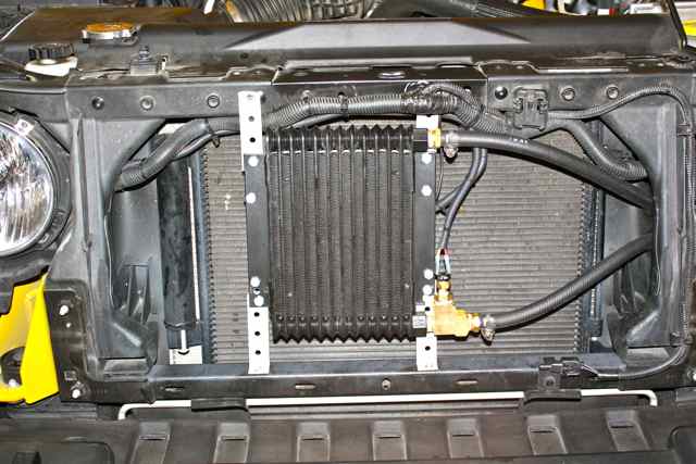

I'm running the BM 70268. I'm in the Phoenix area so I can relate to HOT (115 F = HOT or Damn Freakin' HOT?)
Transmission will still get hot if you run long, steep, slow-speed climbs in Hi range - maybe up to 20-25 MPH. Faster than that is never a problem. Turning on the A/C will force on the fan and helps a lot, but the engine can get hot after a bit.
4-Lo is never a problem. I never have overheat issues when crawling. On the long climbs, slowing down and putting the transmission into low-range for a bit cools things off in a hurry.

slow crawling in the desert heat... I have to think you want one with a fan.
There is a lot of room in front of the radiator. Try a empty shirt box or something similarly sized to test fit the space.
