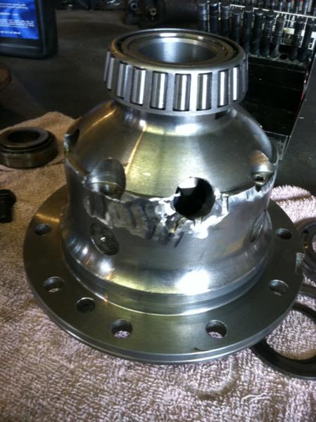

The ARB is scared up pretty good but the internals seem fine. The installer has a brand new atlas 2 he's selling for $1800. So debating on whether to put that in or not.

I wouldn't pay him shit, wouldn't trust the atlas he's trying to push either. I'd tell him to fix everything back like it was, he did a gear install, you left the place and blew your shit to pieces. That's a helluva blown tcase.musta Pinion looks like it did a number on the locker casing.
x2, I agree
