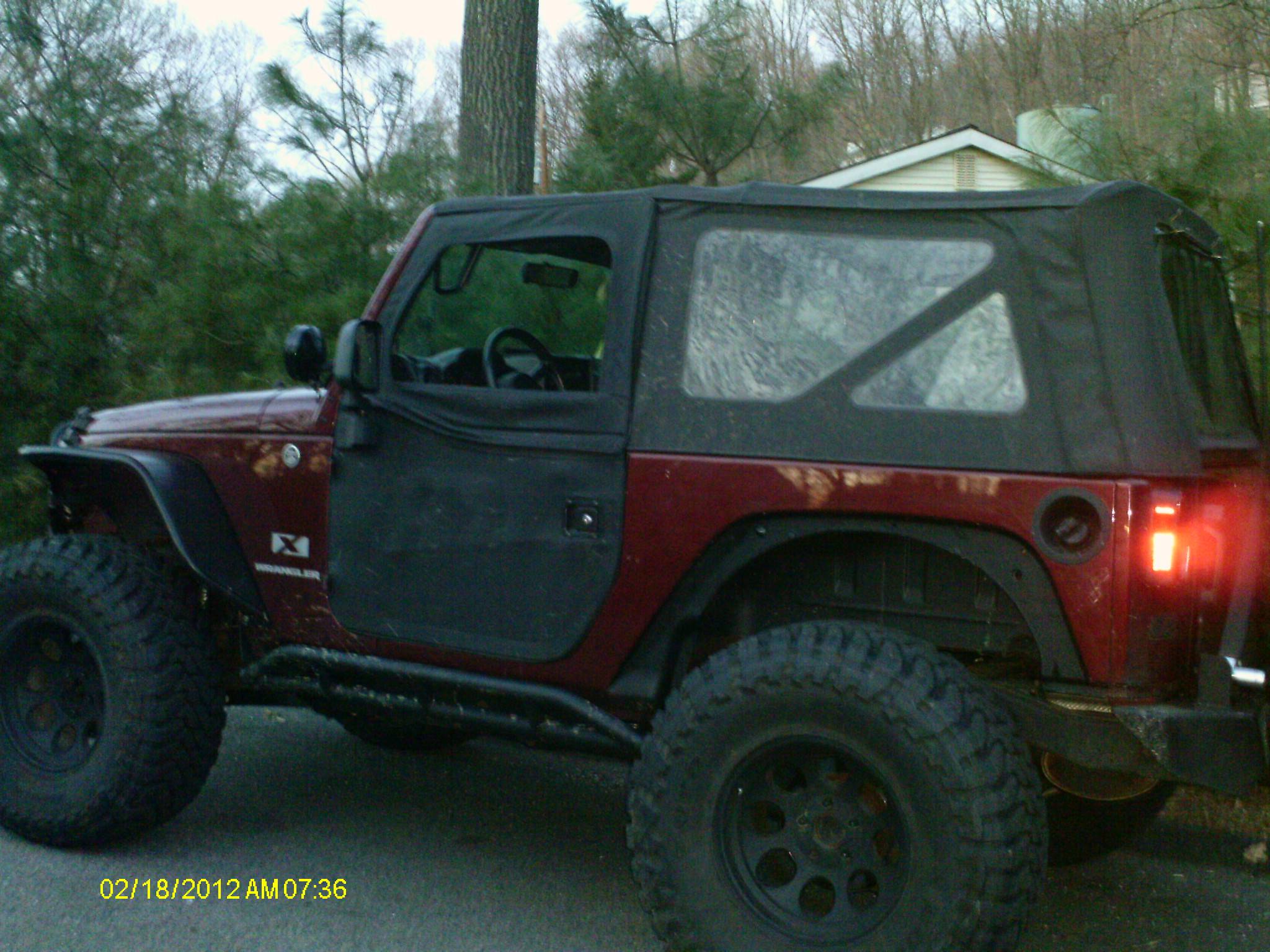

Even though you have a d44 up front, you may still want to sleeve and gusset/truss the front axle.
Might want to regear depending on your engine.
If you don't have a calibration tool, you may want one to adjust everything
For 37s, youll need a nice tire carrier.
Trimi the pinch seam and rocker rails/guards.
With backspacing, I think youll want 3.75-4.5 inches of bs. You can always add washers to your steering stops.
You may need a different bumper setup to allow more clearance. And proper bumpstops with our lift height
---->I have rk 2.5 inch coils with 1 inch rear spacers and a 1 inch body lift. 4.88s, sleeves,gussets,and a superchips tuner, bumpers that allow more clearance and cut pinch seams/rocker guards.. Since im running toyo 37x13.5 on 4.5 backspaced wheels I have to limit my steering with a lot of washers. Since yours will only be 12.5 inches wide you should be fine with 4.5 .

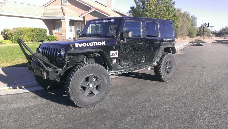

I have a 2.5" lift and 37's with stock wheels and spidertrax 1.5" spacers but I had to put 3 washers in each steering stop so the tires don't rub the frame.
Most people say 4.5" backspace wheels work but some don't. I think 3.5" to 4" would work.
Also some guys are running 4.5"-5" backspaced wheels with spacers too just so the tires don't rub and to have a wider stance
