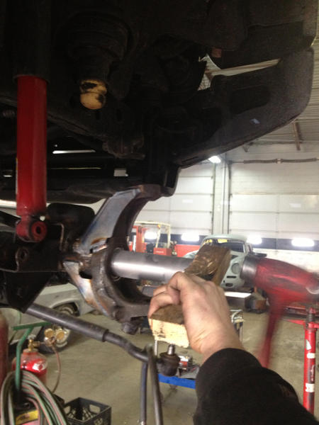

Yep, got em and love em. Nitro sleeves. Actually just set them in the freezer for a few hours, took them out, put them in with very little force from a 10 lb. sledge and block of wood. Happy with them and the best part, no welding, which I can do but why when they offer these?

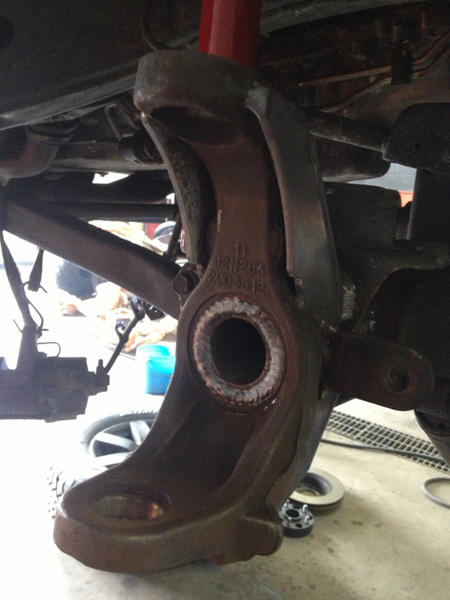

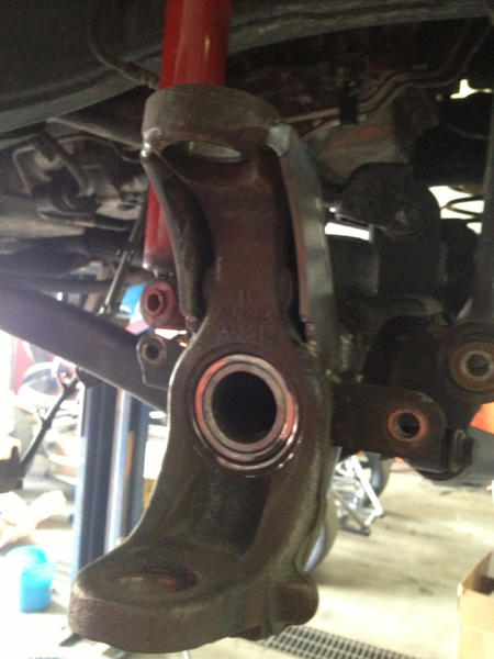

There are horror stories of these Nitro sleeves going in but with a little bit of prep work they'll slide right in! I froze them overnight in my home freezer on the coldest setting. The inner axle tubes were buffed with some emery cloth and the axle tubes were also heated due to having the c gussets welded on.
I'd suggest upgrading your ball joints at this time too!
I welded a bead around the ends just to make sure they stay put.
