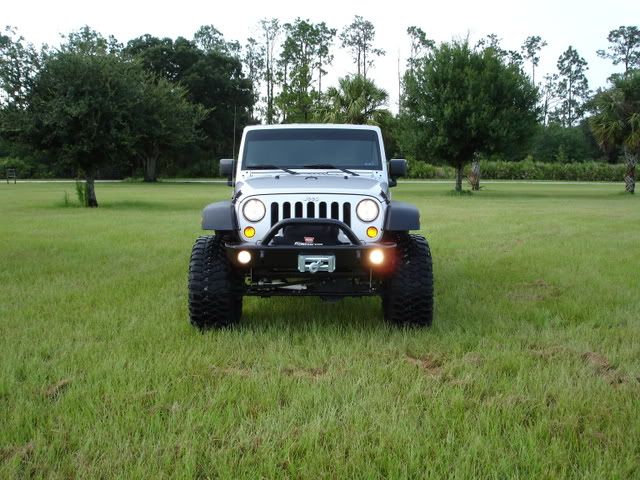

If my math is right this is it: With 9" rim add 1" for a overall width of the rim of 10", The center being 5", Then add the +18mm end up with an estimated 5.75" back spacing. Then take away 1.5" for the adapter to end up with 4.25" Of backspacing. Which is just about right for running a 37" tire. As far as your question about how far they would stick out, The pic below is of my Jeep that has 20x10 rims with 4.5" BS and some 38x15.50 tires. With an inch less rim and about 2-3 inches less of tire you can kind of picture how little they would stick out. Hope this helps some.
