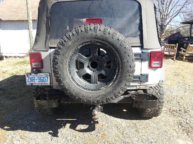

Old Feb 1, 2013 | 09:51 AM
PLOTTHOUND's Avatar
Posts: 42
From: Madison, NC
So this is what i came up with as my product. I like the look alot more than the big clunky plastic bumper cover. All i did was cut up some plate steel and weld it to the chassis as a bracket then bolted the bumperettes into place. Let me know what you think.
