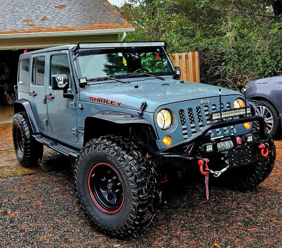

Bought a 2014 JKU about a month ago. After going through replacing my lost keys, I decided to replace the halogen head lights with LED’s. I’m having some challenges.
Here is what’s going on: .
Stock high/low beam lights work on both sides.
New LED works both high/low on drivers side, however light does not work on passenger side.
I’ve switched the new LEDS, both work correctly on the drivers side.
Kinda stumped, appreciate any troubleshooting ideas. Thanks!
