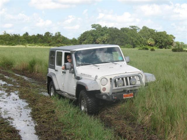

I have it and loved it!
I will not go with any more hight.. Look for your self what my jeep can do!
http://www.aaof.us/jeep.htm
