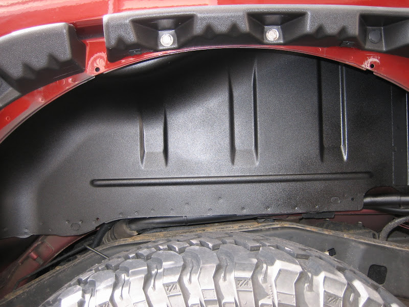

You dont need the rear with the bushwackers, but for a clean install, grab a can of bedliner to paint the wheel well black.
You dont really need the pants for the front either, but it would keep some mud out of the engine area. I used the front, but not the rear with the bushwackers...
FRONT WITH LINERS
REAR WITHOUT LINERS
REAR PAINTED
how tough is it to use bedliner? I'm horrible with paint lol
Bedliner is very easy...just use slow ..movements about 8-12" away. Do multiple coats to get even coverage, dont try to get it all black in the first coat. It dries fast too.
^^^BEDLINER KING^^^^here folks!!!! lol!
it is easy i did my grille and i used one can,,2 coats, and was dry in less than 2 hrs!
