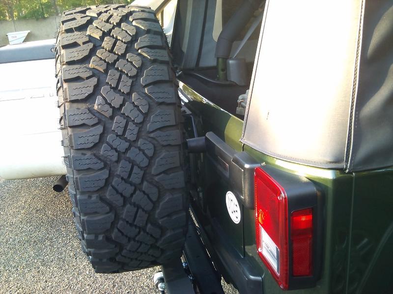

Took a photo of the Olympic tire carrier.
Hard to see, but it's much stronger and really only added about an inch to the overall length.
You will have to add a third brake light. Notice my rubber snubbers don't touch the tire now.
Have to fix that......
