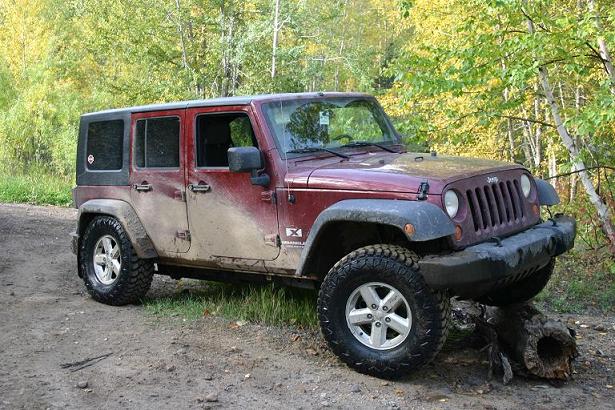

I dunno know about 35's...but I installed a daystar 1.75" BB that came with spacers (front and back), extended bumpstops and and sway bar relocation bracket, I got mine for 170 bucks in may...they are 119 bucks now...check ebay item number: 180185111323
Seriously...if you can tell what size a wrench is, you can install this kit! It took me and my 5 year old about 2 hours to install the front. Thats all I installed on my unlimited was the front...it had crazy rake and the 1.75" took it all away. Now my JK sits nice and level with 295/75R16's on it. For an extra 150 bucks you can get a set with longer shocks. I would recommend that for sure, mine rides a little rougher now, but its a jeep... if I were looking for ride quality, I would have bought the escalade!
