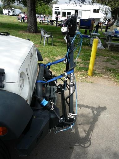

I use the tracker tow bar that slides into roadmaster receiver on the JK
I leave it on , tied off to the bull bar it makes a great brush guard for the bush, and when it's time to leave I drop the towbar with the ratchet strap to ball heigth and drive up to it.
also I use brake buddy system it works great and many options plus a backup camera to check for a flat on the JK when towing
Note: Make yourself a tow key for the JK one with out the chip so you can use it to leave the steering wheel unlocked when towing
