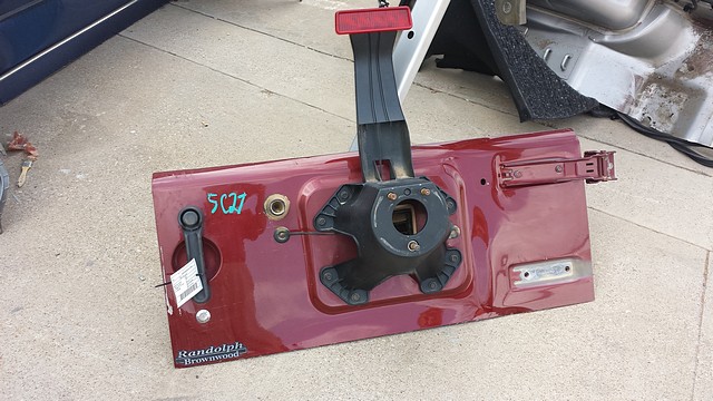

The tailgate I bought wasn't a great replacement, far from perfect. When I talked to the salvage guy, he warned that it was not insurance quality (meaning it needed some body repair time) because of a dent along the bottom edge. However, it was worse than that. The lower dent was there of course, but it was also bent behind the spare tire carrier. Instead of sending it back, the salvage yard discounted it even further. Saving money is good, so we straightened and reinforced it a bit.
The only other body damage was the right rear tail light pocket. The sheet metal was easily straightened using a stud gun. The stud gun allows pulling on metal without drilling any holes (old school used to drill holes and pull with a slide hammer). By pulling in this way the original e-coat (primer) is left intact on the inner side to keep rust at bay. After a light skim coat of metal glaze and primer these two panels are ready for final sand and paint.
