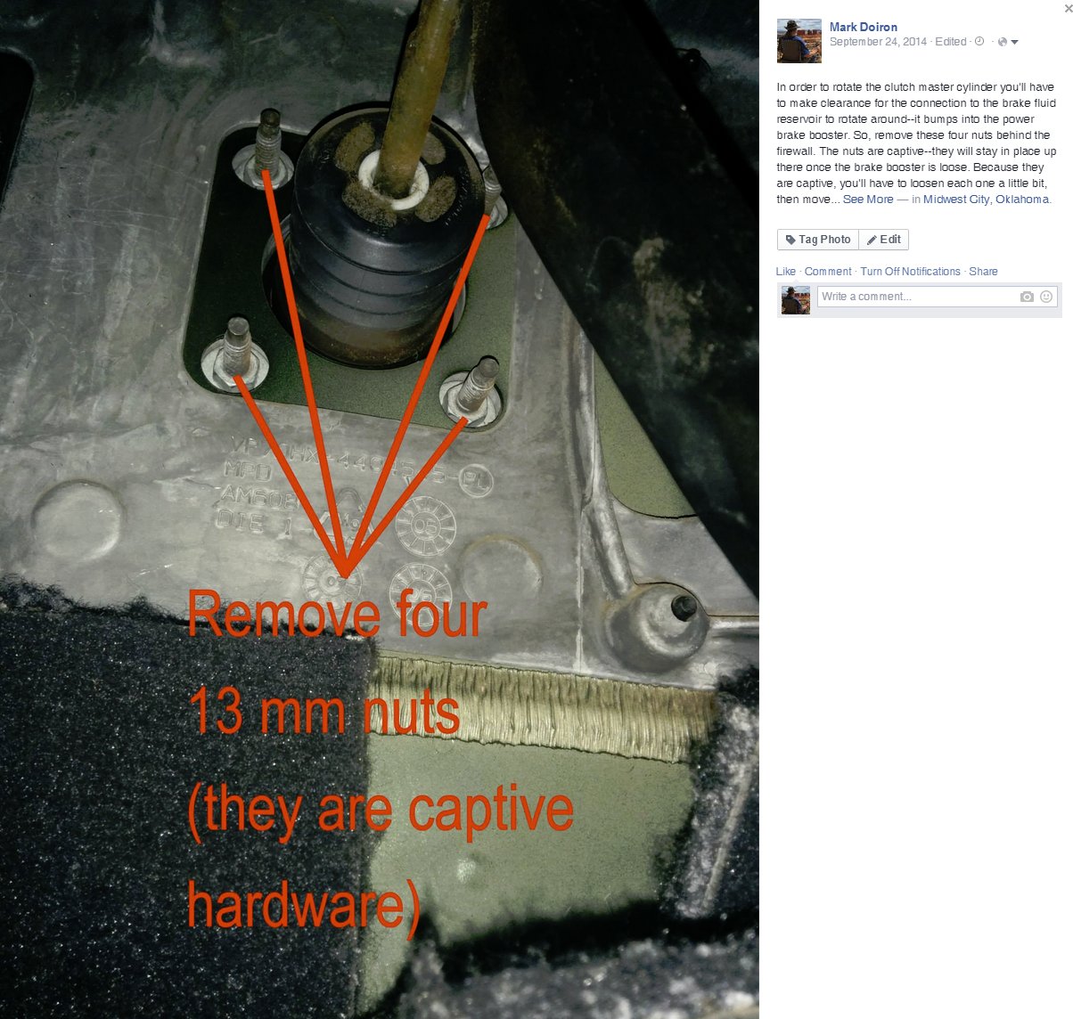

I see the problem with clearance you have--but hold that thought. I want to ensure that you know the nuts are captive hardware. So, they aren't going to back off. You'll have to loosen one a little until it tightens up in the captive housing, then loosen all the others, and keep working your way around. So, you may not have so much of a clearance problem as a problem with bumping up against the captive housing.
This image from my FB page may help ...
EDIT: Oops, let the text truncate in the image below. Here it is: In order to rotate the clutch master cylinder you'll have to make clearance for the connection to the brake fluid reservoir to rotate around--it bumps into the power brake booster. So, remove these four nuts behind the firewall. The nuts are captive--they will stay in place up there once the brake booster is loose. Because they are captive, you'll have to loosen each one a little bit, then move on to another one, keeping all within a few threads of each other on the stud. If one starts to get tight as you're unscrewing it, move on to another one and return to that one when you get the other ones about even with it. From under the hood, pull the booster forward to clear the holes for the studs, then push it to the side--only about 1/2" clearance is needed. Be careful to not put too much pressure on other hydraulic lines.

I worked in a Dodge truck assembly plant part-time in the past when I was going to college and essentially they used air-compressor socket wrenches tuned to a particular torque to fasten things like this down. So if I'm having difficulty getting a socket onto the nut, they should have had the same problem when tightening down those nuts and the nut should have stopped being tightened once the edge of the socket hit the sheet metal. I dunno.
If I had enough clearance room from under the hood, I might even consider taking a sledge hammer and pounding the heck out of the brake booster to see if I can some how get it to slide down into position. I already have a replacement. Unfortunately a bunch of wire harnesses, ABS, and brake lines are in the nearby vacinity and I'ld be afraid something else might get damaged if the metal decided to bend instead of the booster sliding down.

It seems the brake booster can be removed 1 of 2 ways. There's a mounting plate inside the engine compartment that the brake booster mounts. Those are the 4 nuts shown in the pic above. The mounting plate attaches to the firewall by 4 nuts from inside the engine compartment. So if you unfasten the 4 nuts inside the engine compartment, then alls you need to do is push the booster away from the firewall and it comes off with the mounting plate attached. If you remove the 4 inner nuts like I was trying to do, then it leaves the mounting plate attached and you can then remove the brake booster that way as well. That's the reason, some way my inside nuts where off center, because those nuts don't have to be fastened to the plate from inside the cabin.
