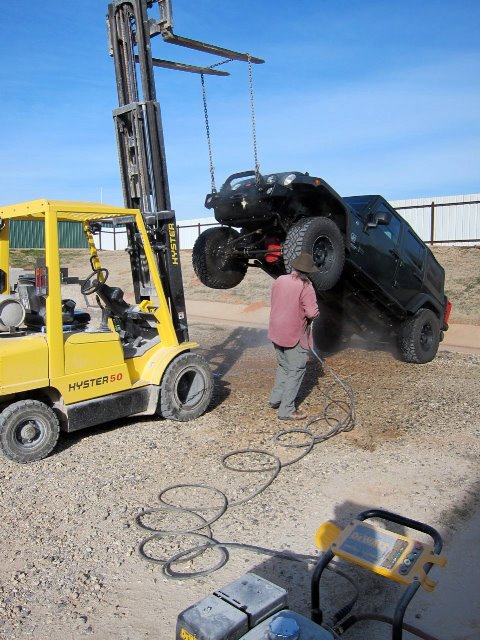

You sure about that? Don't try this with a cheap, Chinese-made bumper.
In fact, don't try it with a great many American-made bumpers. There are subtle design and build advantages to more expensive products. This is Shrockworks. Holes are cut in the bumper and machined billet blocks are inserted from behind and then welded into place, front and back. To have those tow hooks fail, you'd have to pull the billet block through a 3/16" steel plate, deforming the billet flange and/or the hole in the steel plate. Not cheap, but to the best of my knowledge, no one else builds tow hooks like this.
And, after seven years of ownership of Shrockworks front and rear bumpers and rock rails, not a speck of rust except where the powdercoat was scratched on the rocks. I wish I could say that for some of my other US/Canadian-made products (and don't even ask about that Chinese junk).
Attachment 644330
I would do that with my Smittybilt SRC and not think twice about it. Look at the amount of fillet weld on the shackle mounts, even if it is standard E70 mig wire, there is many times more weld area than would be required to lift that little bit of weight. I tried to google for any posts talking about tore/ripped shackle mounts from bumpers but I failed to find one. I do believe that you have a great bumper and that you love it long time, but I hardly see lifting a couple thousand pounds as a challenge for anything but maybe the factory Tupperware bumper.
