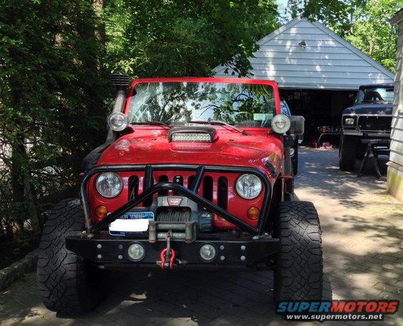

Here's mine with a 2" front hitch for my fishing rod holder, it's an Olympic 4x4 front 'Rock' bumper with front hitch. I've now had it 7years ! It holds up very well to fender benders and through the NY winters with salted roads --- great value for money at less than $300. When looking the only two choices were Olympic and Nates 4x4 with an integrated 2" receiver.
