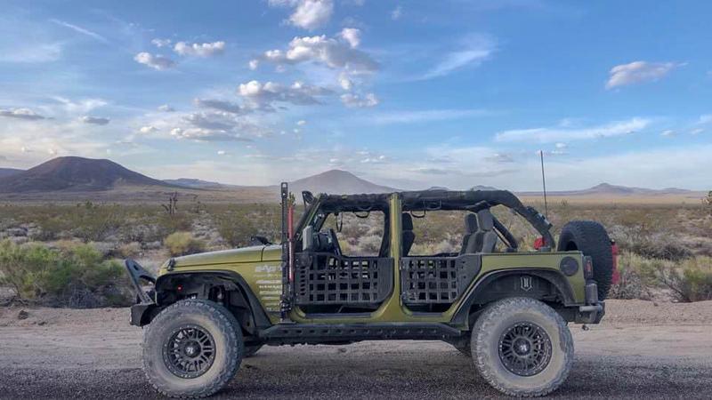

Here is a shot of my Jeep out in Mojave with EAG Matrix Tubular Doors.
