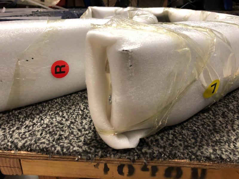

Today on the Jeep, we installed part number 51-0694 & 51-0695 which are stubby fender flares. We first started by laying out our fenders. *Notice the packaging will have an L or R for Left and Right side.

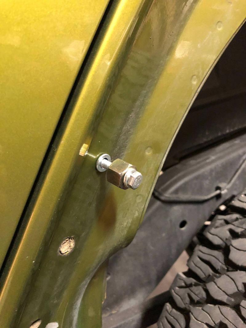

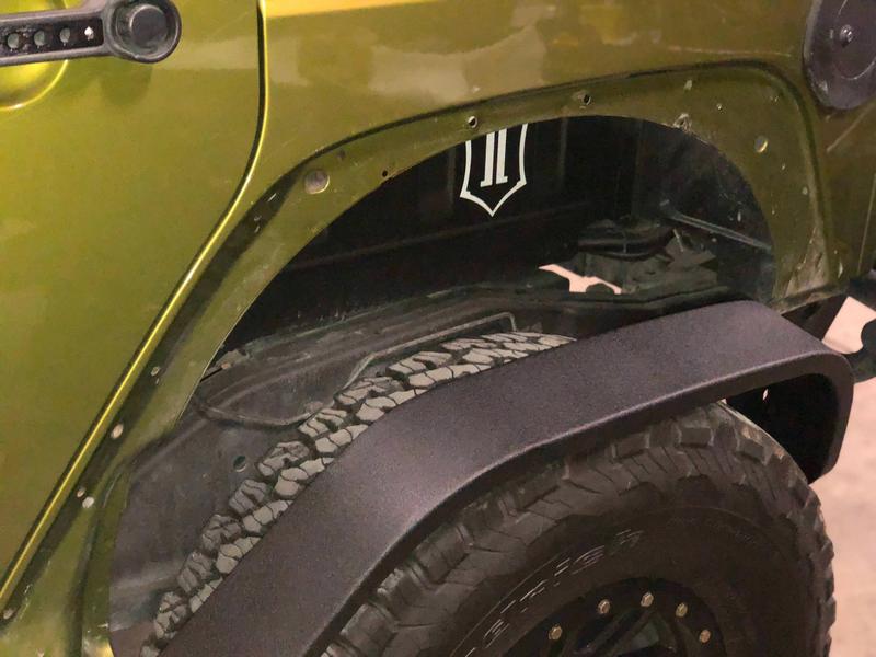

Once we have removed existing fenders (OEM/Aftermarket) start by placing the rivet nuts in the designated holes in the rear fenders and using the provided rivet nut insert tool, screw until rivet nut does not come loose. Repeat the process 4 times on each side. With the help of a friend have them hold up the fender and bolt on the bolts into the rivet nut and using the provided bolt and washer, place them through the center two holes and from the back side use the locking nut to tighten the fender.
