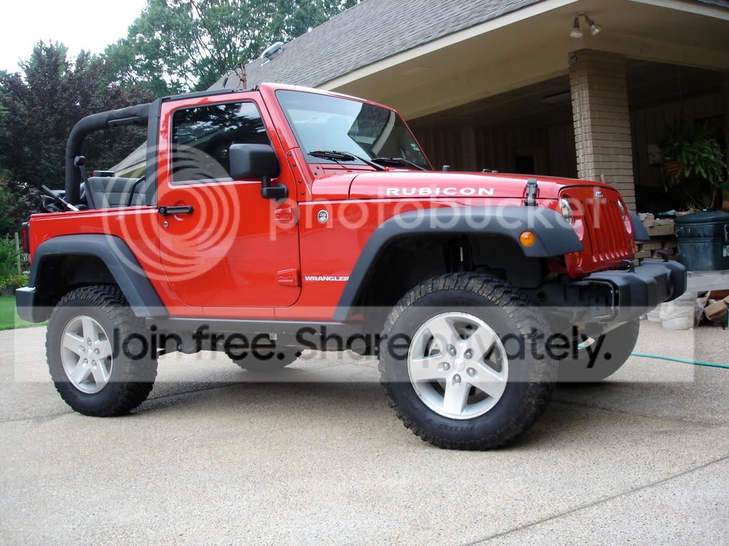

I removed it and folded it back, just cut strait off looks extreamly Gay to me.
https://www.jk-forum.com/forums/show...?t=6331&page=9
The pics of the red jeep are basically what mine looks like, I used his as a referance. There are alot of other pics in the thread though if you look through it.

I stubbied my front bumper last month. I wasn't too hot on the idea of trying to fold and heat weld the plastic, so I decided to cut and reinstall the ends as caps. The metal rebar with the cans I trimmed about 1/2'' past the two outermost holes on each side. this is the attachment point for the plastic bumper. The plastic bumper I measured an inch outside the can hump and ran a strip of masking tape parallel around the bumper . I then measured 10 inches further towards the outer end of the bumper and ran another strip of masking tape parallel around the bumper at this point. This gave me a 10 inch section of bumper with pretty even ends to remove. Take an angle grinder with an 1/8'' thick cutoff wheel and saw thru both tape lines. The cap is what you have left on the outside ends of the cut pieces. Clean the cut edges lightly by scraping the edges with a razor knife after they have cooled. Decide on how much overlap you want on the cap, about 1'' worked good. slowly trim the cap to fit inside the centersection of the bumper. Take a piece of masking tape and make a rivet spacing pattern with an ink pen, then install on the edge of your centersection and drill all the holes. Remove that piece of tape and put on the other side so you can duplicate the rivet holes. Install your trimmed bumper end at the angle you want it, drill the first hole on thru into the cap and set the rivet. Check your cap position and then drill the next hole, till you have the caps on. Reassemble bumper and install. These are black aluminum rivets, split shanks so the rivet won't pull thru the plastic. the back flowers out instead of swelling up. The pictures don't do it justice, I'm very pleased. I don't know how to move pictures around, they are in what did you do to your JK this week, page 260 #2591. Hope this gives some fresh ideas....
