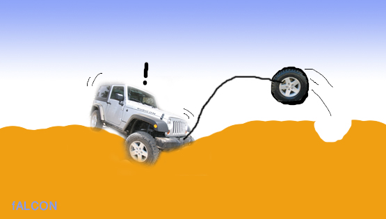

I haven't tried this myself but you can dig a hole with a small shovel and bury your spare tire with the winch line attached to it to use as an anchor point. It seems you would have to have the tire buried at least 2-3 feet deep.

yeah i definitely wouldnt want to be around when the pulled tight winch line pulls up the tire....
Just what do you think would happen? If you don't have it deep enough it's going to pull out slowly. It's not going to go flying.
How many people have tried to pull themselves out using a tree and had the tree fall on them? You have to watch what's happening. If it doesn't "feel" right stop and rethink it.

a flying tire .. i dont think so
its still a solution.
and that pull pal is a great idea
I saw how it works here
https://www.jk-forum.com/forums/atta...1&d=1225674967
in the dry sand .. there is no way it would fly , ya ?
