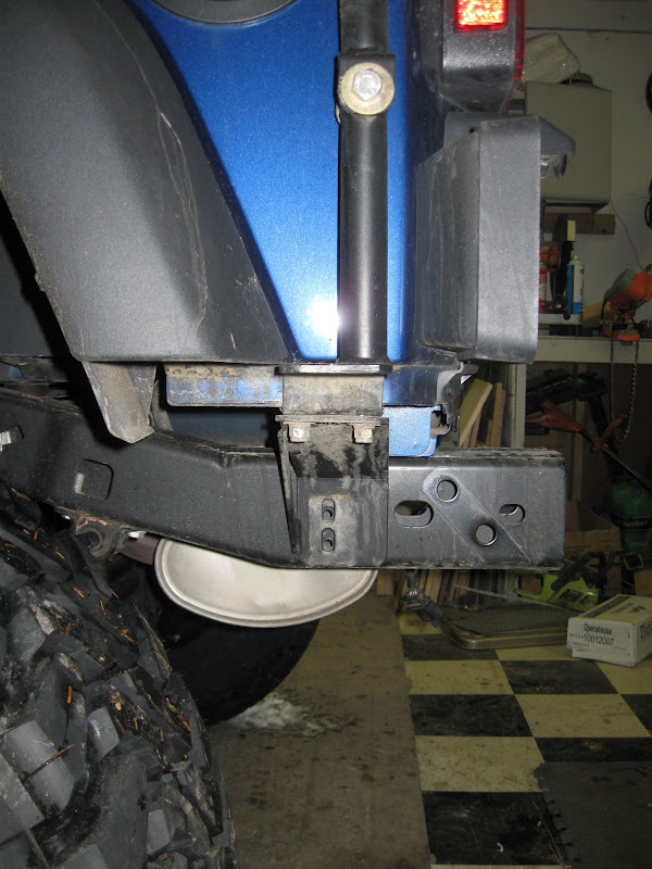

the things you see on the rear quaterpanel that look lik they could be bolts are adjustable screws with rubber feet just for lateral support. As seen here:
It just sits on the bumper, and is bolted to the frame with that bracket you see in the photo I posted. In the front, its mounted to the windshield frame with a bracket that uses factory bolt locations. See photo:

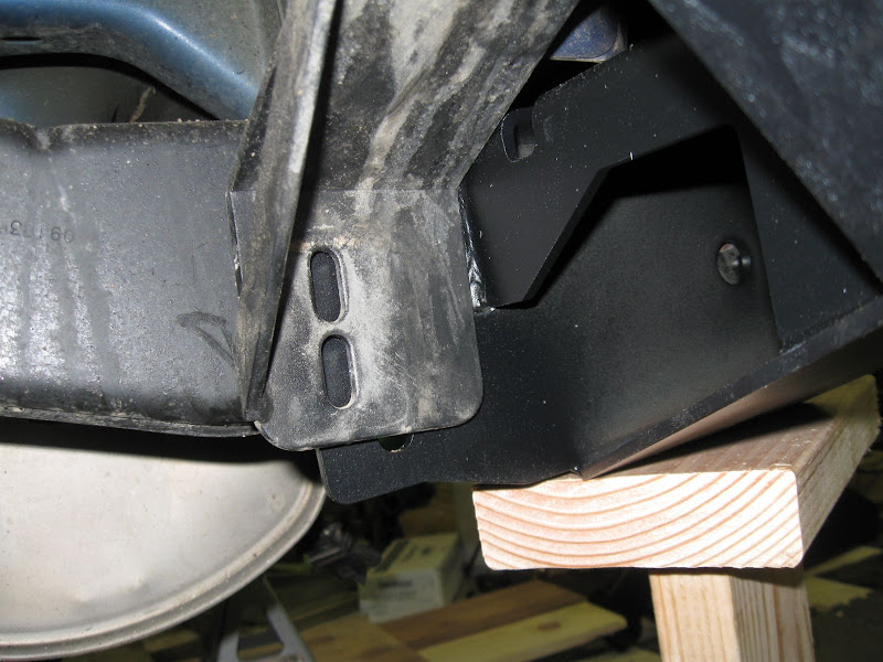

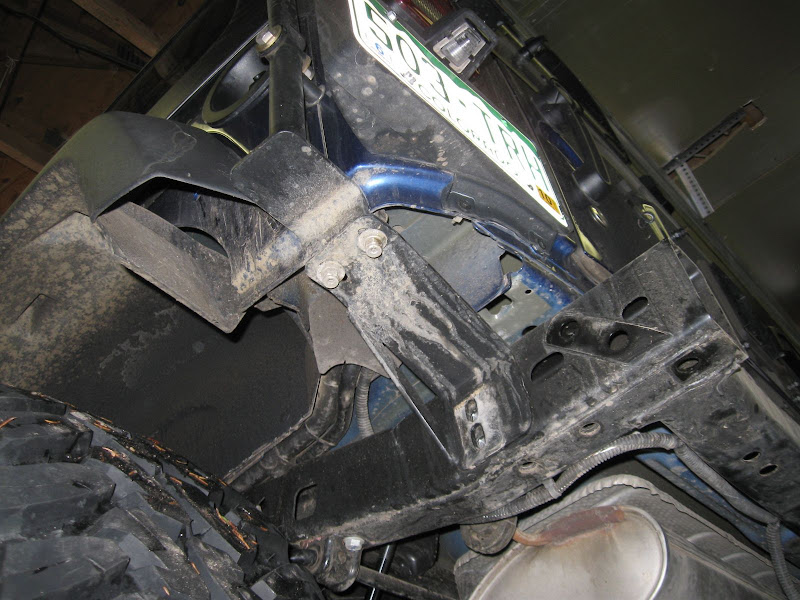

Here are some photos I took after the stock bumper was removed so you can clearly see the Gobi bracket that supports the part where the down tube meets the down tube by tieing it to the frame.
I put a 2x4 under the Gobi rack to support it since I wasn't sure what would happen when I unbolted the bracket and the rack was still up there on the jeep. Turns out it was no big deal and I removed the wood.

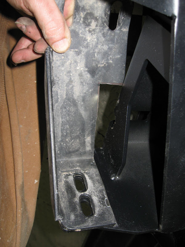

Here is a photo of the Expedition one bumper slid mostly into place. The plate that mates up to the frame rail is not as far forward as it can go because part of the internal structure of the E1 bumper is hitting the Gobi bracket.

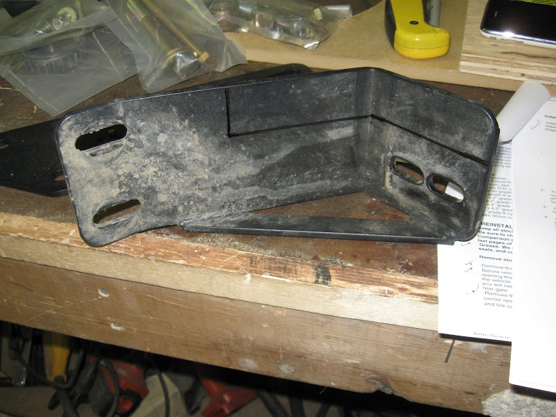

Here is the section of the Gobi bracket I cut out.
I checked it against the bumper before installing everything again.

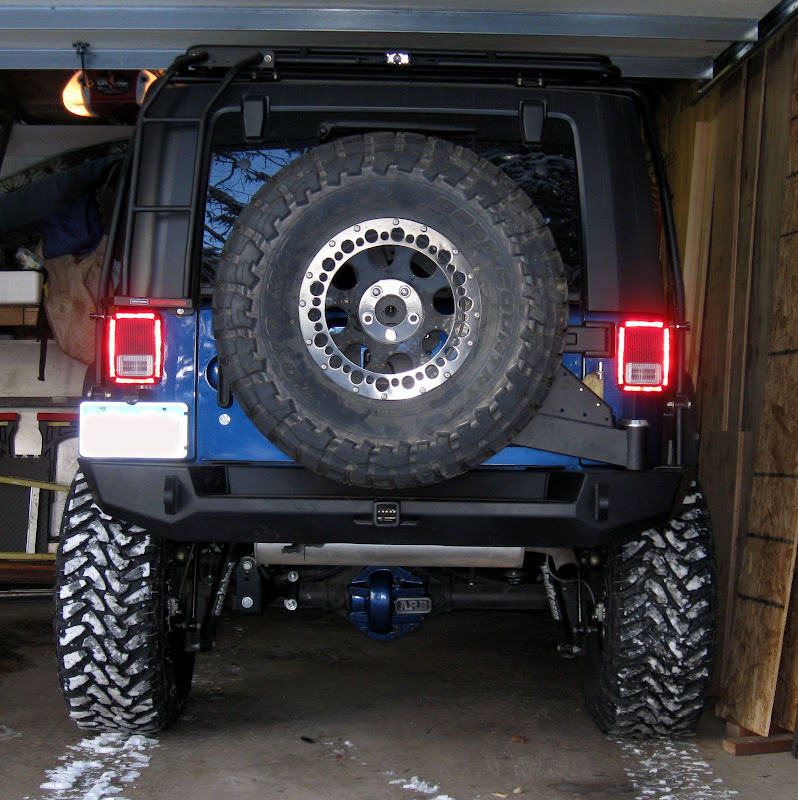

Here is the finished product with both installed.
Last photo, you can see here how the foot of the Gobi rack sits directly on the E1 bumper.
