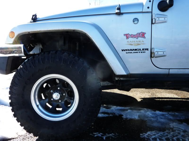

I have Ion Alloy 171 - they have a few different styles. backspacing might be more than other wheels but I like them and they are about as inexpensive as they come. Got mine at Canadian Tire. Fit my 2007 just fine. 33x12.5x15 Duratracs on them.
Sorry it's not a stock suspension. 2.5" TF coil lift.
