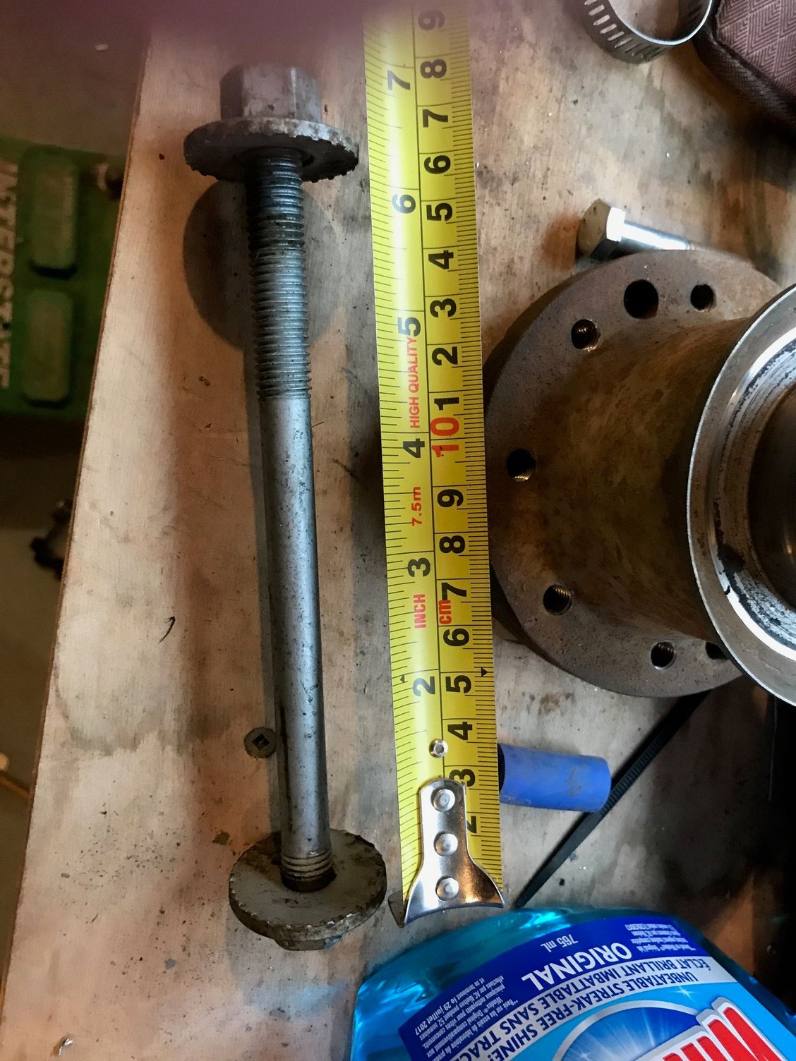

This is the one that holds the mount to the frame. M11x170mm

There are two of these and they sit through their respective engine to chassis mount with the nut on. When you install the engine it fits in the slots of the chassis mount then you simply tighten it up once it is seated. From a stock 2008 JK. If yours is different then someone modified it.
