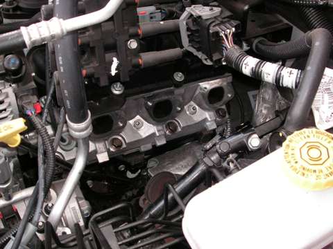

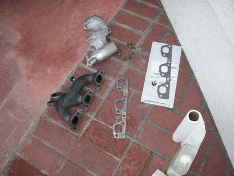

Pulling the manifold was simple, but I found no evidence of leaking between the cylinder head and/or the collector mechanical joint. It only took a couple of hours to do the whole job. Now I'm thinking it's a broken weld somewhere? It's just so hard to pinpoint because it only makes the noise under load.
